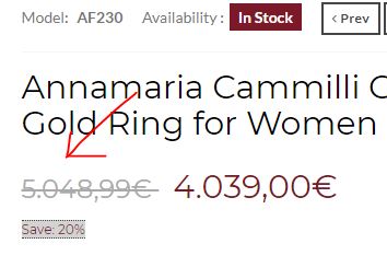

sooo..... when a product is on sale, how do i get the "normalprice" to include the taxtation?
At the moment it gives:
Price: £649.17 £467.40
Save: 40% off
Save: 40% off
forgot to say, product price "zero", product priced by attributes.

Yes, there is a "proposal" in the github found at: https://github.com/mc12345678/Dynami...195351319d5460
I intend to include it in the next version release: https://github.com/mc12345678/Dynami...ter/tree/3.2.1 but have been working through a few issues. One of which is of interest is to conquer any flashing values as a result of typing text. Would like (if the replace value with an image is chosen) to be able to set a timer to not allow the flash to occur. Some of this is incorporated in this branch that is to also go into the next release: https://github.com/mc12345678/Dynami...-reduce-events

many thanks, the link provided the solution i needed
