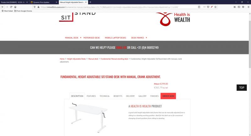

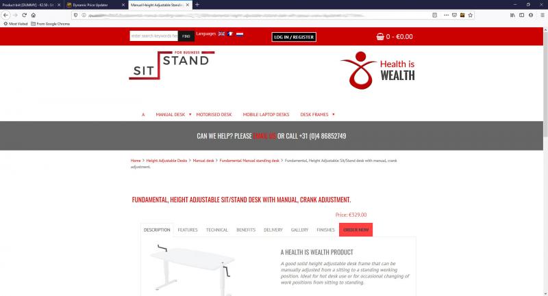

In fact, I think it would be easier for me to make the site live, so you can see what the issue is.
Looked again at the source code generated on the page and see that the current display doesn't have discreet divisions between each of the text items, so just returning different values for tax/non-tax. It appears, that instead would need to return the full text to be displayed as a single value.
To try to do that, I went to search for a module that expressed compatibility with any recent version of Zen Cart. While I suspect the one I found would be compatible, I wanted to ask what module is being used so that perhaps I could use its results for the returned value instead of trying to do some sort of javascript muddling.
What I had been using was Dyanmic price Updater and https://www.zen-cart.com/downloads.p...=597&styleid=4 (which I know is a bit out of date).
It does show on my test site
Attachment 18898
and then when the page is fully loaded, it replaces with this
Attachment 18899
The piricing for both did update when options/quantities were changed.
I hope this helps. Please do let me know if you would prefer to see the site live.
