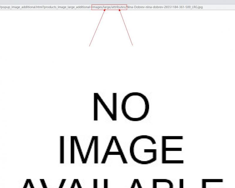

Attachment 18901
The attribute picture can replace the main picture normally, but the main picture after replacement cannot be displayed normally.
not work at Image Handler 5 (Zen Cart 1.5.5+).
Enlarged picture cannot be displayed.
Uninstall Image Handler 5 (Zen Cart 1.5.5+) and it works:(

ikirin
Attachment 18901
I thought I remembered seeing an issue in the IH5 forum thread about issues with the suffix _LRG being added to filenames when that file did not exist. While this seems to occur when using this software, because it doesn't work with IH5 and does without, it would seem that there is an issue with the particular version of IH5 installed. When you go to that thread, after searching for the similar issue, if posting, please identify what specific version of IH5 is installed.

Thanks for the response,I am looking for help on IH5 thread,IH5(V.5.1.8) does not seem to be able to compress attribute images.

ikirin
Attachment 18903
See this IH-5 support-thread posting for the change needed to provide interoperation between IH-5 and this plugin.

Works perfectly, thank you very much for your response:cool:
