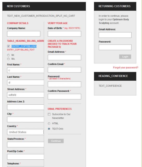

I am using Zencart 1.51
I installed Fast and Easy Checkout 1.14.2
The issue I have is that some of the language isn't being copied into the template. See example
Attachment 13463
It did it when i first installed, so i went back in and reuploaded all the files and redid all the changes they listed on the site. I can't figure out where I need to look to fix this. Suggestions much appreciated.

Please check these files, are present
includes/languages/english/YOUR_TEMPLATE/create_account.php
includes/languages/english/YOUR_TEMPLATE/login.php
includes/languages/english/YOUR_TEMPLATE/no_account.php
Re: Fast and Easy Checkout for Zen Cart
bislewl
and make sure that you changed all of the folders named "YOUR_TEMPLATE" to match the name of your templates folder..
YES! thanks that worked, :hug:

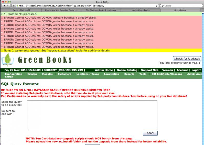

I have the same problem...Don't have a sql file and fail to install.
Below, I stole v1.11.2's sql for v1.14.1's installation. (Cause I find .sql file only existed before 1.11.2)
Of cause, I failed.
Attachment 13465
Not things change except the same layout in #1648:

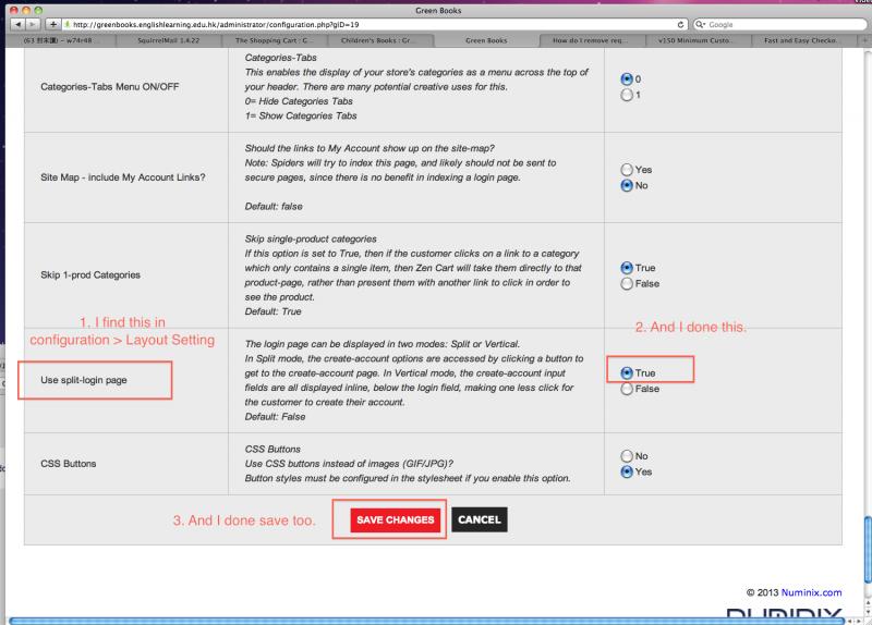

I followed all the instruction but still fail...... (I done all step except the optional changes and step 11 & 12)
For step 10, it is okay.
10. In the Admin Panel, go to Configuration->Layout Settings and set "Use split-login page" to True.
Attachment 13467
