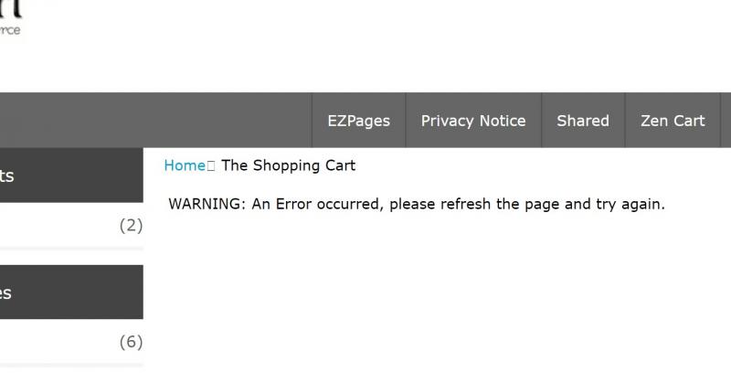

Hello, just reporting the issue. Plugin is not functioning the way you could expect. Latest zen cart v1.5.6c. Whenever I try to edit the cart I get this message in response. The item remains in the cart though, you can also add another one, but checking the cart content you getting the same massage.
Attachment 18717
Also it is extremely difficult to merge my active template's file tpl_shopping_cart_default.php with correspondent file in plugin's file-set. So I'm presenting the basic responsive classic's version.
Re: Save For Later Support Thread
Yep, Save for Later needs some more work for 1.5.6. I thought it was done but I can see a couple of issues.
