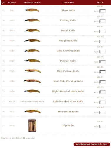

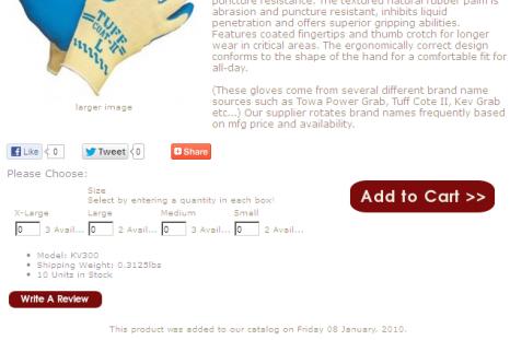

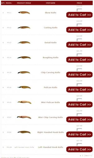

Thank you for the link.
I installed both modules into my test site.
They work but with some oddities.
I can only display a single row with all the attributes instead of on top of each other like your site.
Also the add to cart button is showing up on every item in the all products by category page.
There used to be only one at the bottom of the page.
Attached are some screen shots.
I would post this on the other thread but you seem to have had success integrating the two.
