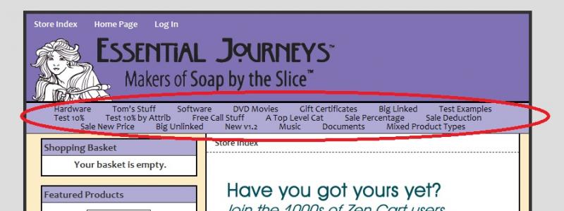

I am upgrading a 1.3.8a Zencart site to 1.5.1. I have a base install of 1.5.1 up and running with ImageHandler and Zen Lightbox addons and two templates. I've installed Multisite 1.0 and it *appears* to be working, but I have a question. In the attached image, the circled area does not respond to the category allocations for the respective sites controlled by Multisite.
What is this are called, in Zencart terms? What file/files control the categories shown in this area?
In the production 1.3.8a site (with Multisite running there also), this area of the page DOES respond to category allocations by site.
Any thoughts?
TOm
Attachment 12587

Does the file includes/modules/YOUR_TEMPLATE/categories_tabs.php contain the next line (around line 20)
$categories_tab = $db->Execute(cat_filter($categories_tab_query));
the original is
$categories_tab = $db->Execute($categories_tab_query);
Re: MultiSite Module Support Thread
Ah! That worked! Thanks!
Actually, categores_tabs.php was not under MY_TEMPLATE folder, but I found it, added the cat_filter() call and placed in both of MY_TEMPLATE folders. It is one of the files that I had to address in the 1.3.8a --> 1.5.1 upgrade, but did not get to it yet.
I'll keep this in mind for other anomalies that I encounter along the way.
Appreciate the help!
Tom
