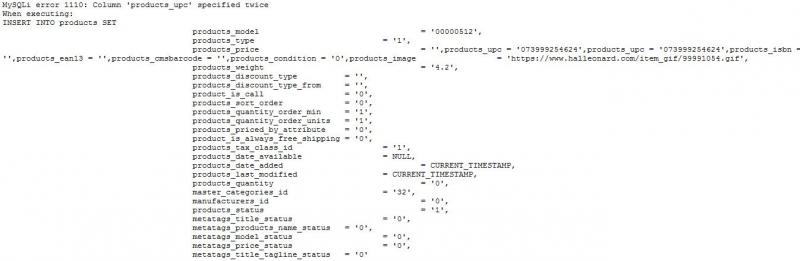

I am having an issue importing new files using Easy Populate 4.
When I import, it gives me errors for my new products. When I take a look at the debug log, it appears as though it has duplicated my v_products_upc column for each of my entries.
If there is an entry that already exists on my cart, it will update that one correctly, it's only giving an issue for the ones that are new.
I have attached the CSV file in question, as well as a screenshot of the debug log with the upc error. Help!

Have you added the upc field as an additional user defined column in your configuration panel? The code should automatically take care of considering that field if it has identified that you have the UPC mod installed (which I would presume you do). So you would remove that field from your configuration area in the admin and now should not have the field populated twice on the import... As for why it doesn't appear twice on the output is because, well, it already was in the data array initially and then when the system checked against the user defined field, it didn't have to do anything because it already existed...

Sorry for the trouble. Issue fixed!
They use excel to export the .CSV files, and saved as type MAC instead of MS-DOS. Even though they look the same in Notepad++, it wasn't importing.
Furthermore files export with "", but it can be imported without the "".
