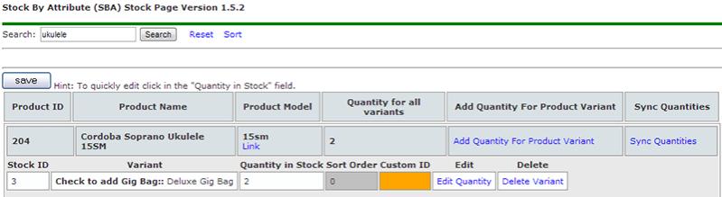

HI, is it possible to do a 'bulk' or 'batch' action to "Add Quantity For Product Variant" on all products at once?
My problem see, is that I seem to have to mouse-click on "Add Quantity For Product Variant" for each product, then select ALL and the add Quantity to create the Stock ID.
I'd like to be able to Add "Quantity For Product Variant" on all products that have attributes at once. As I have 2000+ products, all with the same 15 attributes. And it is taking some time to do this individually, product by product, just to create the 'Stock ID'
All help appreciated, thanks
I would say using phpmyadmin you should be able to do this. There would be a query you could run that will populate all the fields with 15 or whatever stock level you want. Im not sure what the query would need to be exactly though.
ray-the-otter
This depends on what version of the mod you are running.
If you are using the version 1.5.1.2, than this functionality is built into the installation script as a selection.
After installation you can use the "Run Optional SQL", This script will Makes entries into the new SBA Table based on the products that have attributes associated.
After running the script you can do an export 'Export Table Data' of the table to a CSV file and update the stock using excel (save file as CSV), use "Import Table Data'... This is explained in the documentation under Optional SQL:
Optional.sql
The Optional SQL script is intended to initially fill the stock table with the same quantity that the product has. The script only creates entries for products that have associated attributes.
The first time the script is run on a clean new installation (the new SBA stock table is empty), then all found records are added.

As a test, try setting the attribute stock page like the following (ignore the customid field, that will be in the next version)
Please let me know how this goes.
Product ID |
Product Name |
Image |
Product Model |
Quantity for all variants |
Add Quantity For Product Variant |
Sync Quantities |

Under admin>Configuration>Stock
set
Check stock level = true. They will get the Out of stock warning on the product_info page
but the problem is when I add the same item with a different attribute and it ALSO show as out of stock when it really is not.
and one of them is out of stock, you will get the red
Attachment 13326
First one has no stock, when added to cart it informs me such... ok
Second one has 11 items in stock, when added to cart, it says the same thing as the first item... not ok
Attachment 13327
I have a different product that has only one attribute and it's working as expected and showing 'out of stock' on the product page.
Leslie
I hoe it helps.

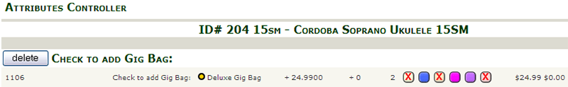

- settings in attributes controller:
Attachment 13519
I'll appreciate your guidance.... Thank you!

Can you provide a screen shot of the product setup in the SBA stock page, this may help in understanding the issues cause.
I will attempt to duplicate your settings this weekend and see what I find.
Re: Quantities of items with attributes are incorrect, how to fix?
potteryhouse
Thanks, Potteryhouse, here are the shots:
Attachment 13525
Above quantities are NOT synchronized. Syncing changes total # to 4.
Attachment 13526
Ok, I may have missed something but, if the quantity amount for an attribute isn't filled in, is this treated as a zero quantity of stock or an infinite quantity of stock
I think it shows out of stock with quantity of zero.
nigelt74
The way I updated the code it should do the following:
Option A: Product with no associated attributes, this uses the qty assigned to the product in the catalog.
Option B: Product with Attribute(s), If no attribute is created in the SBA Stock page, this will use the qty from the product catalog.
Option C: Product with Attribute(s), and attributes are created in the SBA stock page, this uses the qty from the SBA Stock page.
In all cases,
if the qty is zero, than the flag is set to indicate out of stock.
if the qty is less than the order requested in the cart, than the flag will indicate low stock.
The flag display is based on the settings in the "Configuration -> Stock" (Check Stock Level = true)
There seems to be other configurations to support:
1. Where the base product is to use the quantity in the catalog, and there is an "Optional" attribute to add something like a "Gig Bag".
2. Where the same product is added to the cart, but one has a selected attribute combination as A,B,C, and the second entry for the same product has attribute combinations A,C. etc. These do not properly cross check the other attributes of the same product to test for available qty.

This took much longer than I thought, but I think it resolves most of the duplicate product issues you identified.
It is not perfect, but much better I think than it was.
It is a big change so you should try this on a test machine before trying on any production site.
Verify everything works as you want. No guarantees, but I hope it will work for you.
A note, for products that have attributes, you must have "None" or "All" of the products attributes setup in the SBA Stock page, it will not work if you only put one attribute in the stock page but there are others for the product.
Also, the "Attributes Controller" for the "Uke" product should be set like I have in the attached image sample.
Attachment 13601
Attachment 13600
If you find other things or have suggestion please post them.
