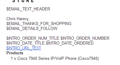

2nd step is to edit orders.php, When i do i get text errors in mine and customers emails.
reverted back to Default orders.php and all seem well.

when i add in this
Open includes/classes/order.php and find:
CODE: SELECT ALL
zen_db_perform(TABLE_ORDERS, $sql_data_array);
Add before:
CODE: SELECT ALL
if ($_SESSION['COWOA']) $sql_data_array[COWOA_order] = 1; // FEAC
Find:
CODE: SELECT ALL
//intro area
$email_order = EMAIL_TEXT_HEADER . EMAIL_TEXT_FROM . STORE_NAME . "\n\n" .
$this->customer['firstname'] . ' ' . $this->customer['lastname'] . "\n\n" .
EMAIL_THANKS_FOR_SHOPPING . "\n" . EMAIL_DETAILS_FOLLOW . "\n" .
EMAIL_SEPARATOR . "\n" .
EMAIL_TEXT_ORDER_NUMBER . ' ' . $zf_insert_id . "\n" .
EMAIL_TEXT_DATE_ORDERED . ' ' . strftime(DATE_FORMAT_LONG) . "\n" .
EMAIL_TEXT_INVOICE_URL . ' ' . zen_href_link(FILENAME_ACCOUNT_HISTORY_INFO, 'order_id=' . $zf_insert_id, 'SSL', false) . "\n\n";
Replace with:
CODE: SELECT ALL
// FEAC
// COWOA Conditional
if ($_SESSION['COWOA']) {
$invoiceInfo = EMAIL_TEXT_INVOICE_URL . ' ' . zen_href_link(FILENAME_ORDER_STATUS, 'order_id=' . $zf_insert_id . '&query_email_address=' . $this->customer['email_address'] . '&action=process', 'SSL', false) . "\n\n";
$htmlInvoiceURL = EMAIL_TEXT_INVOICE_URL_CLICK;
$htmlInvoiceValue = zen_href_link(FILENAME_ORDER_STATUS, 'order_id=' . $zf_insert_id . '&query_email_address=' . $this->customer['email_address'] . '&action=process', 'SSL', false);
$invoiceInfo=EMAIL_TEXT_INVOICE_URL . ' ' . zen_href_link(FILENAME_ACCOUNT_HISTORY_INFO, 'order_id=' . $zf_insert_id, 'SSL', false) . "\n\n";
$htmlInvoiceURL=EMAIL_TEXT_INVOICE_URL_CLICK;
$htmlInvoiceValue=zen_href_link(FILENAME_ACCOUNT_HISTORY_INFO, 'order_id=' . $zf_insert_id, 'SSL', false);
//intro area
EMAIL_TEXT_ORDER_NUMBER . ' ' . $zf_insert_id . "\n\n" .
EMAIL_TEXT_DATE_ORDERED . ' ' . strftime(DATE_FORMAT_SHORT) . "\n\n";
$email_order .= $invoiceInfo;
// END FEAC
I get email text errors

Sorry if this is not the place for this... but...
I have my zen cart working nicely... and the FEC plugin...
I have an issue with the emails sent when a customer uses the 'Guest Checkout'
the email sent to the customer doesnt have Template Keywords replaced with the corect text.
if you sign up, and checkout, it all works as it should.
Could someone point me in the right direction to solve this problem...?
Cheers, and thanks in advance
Attachment 13953
You'll need to check customizations you've made to includes/classes/order.php. Make sure they match the modifications mentioned in the FEC docs. The only edit that is made to that file shouldn't cause the issue you are having. You may want to try redoing the modifications with a default file from the ZC 1.5.1 package (or whichever version you are using). If other mods have made modifications to that file, remember to also add them to your new file and make sure they do not conflict with the changes for FEC.
Also note: if using FEC, you should not be using the standalone Checkout Without Account mod.
