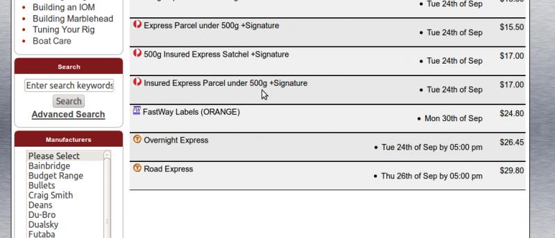

I've just tested using our 'Demo' account (which is actually a 'real' account belonging to a friend of mine) and all seems to be working fine.
Just to be sure I've also tested with another site that also uses TNT, and no problem there either (radiosailingshop.com.au. Screenshot attached)

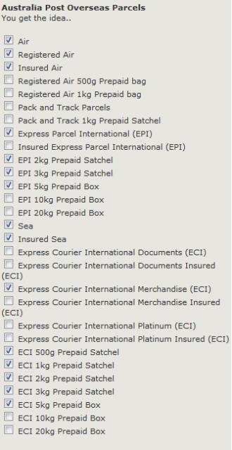

We have issue with Rates of Ozpost for Overseas Customers.
We have set following configuration in backend.
Attachment 13107

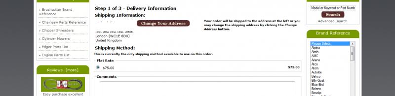

But it only displays one rate on front end. Flat Rate
Attachment 13108
Is there any solution for this issue?

nlinksolution
Attachment 13107
Attachment 13108
I've not been able to replicate the problem. Can you please provide a link to the product(s) that you are using for testing?

Few people realise (or appreciate) that even where the information provided is minimal, I go to great lengths to research any and all reported problems, so even though Naren provided no textual information regarding the problem site, the screenshot provided me with a clue as to where to look so that I could investigate further. Such investigations are often the cause of delays in any responses I give.
My test purchase (outdoor king site) didn't show any issues with overseas quotes, ergo, my conclusion is that it is a product related issue rather than a destination related issue.
