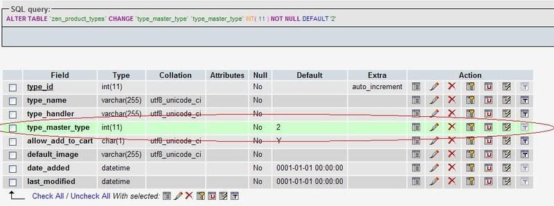

I dont really know much about coding unfortunately :-( and yes, all my products are music products, how would i tweak EP to include feilds for record company and music genre?
i also "i think" set the product type to equal 2 but it didnt work i think i did something wrong :-( is this what i was supposed to do?
http://i33.photobucket.com/albums/d5...nscel/type.jpg
You got it wrong. Change that back.
products_type is a field in zen_products table
Thanks Jeff, i fixed it!
