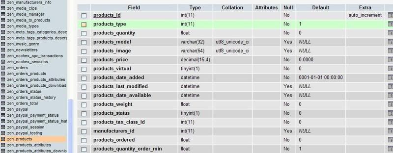

Jeff,
Below is the image showing what i am changing am i doing it wrong? please let me know
http://i33.photobucket.com/albums/d5...cel/type-1.jpg
Re: Easy Populate support for Version 1.2.5.4
I don't see any changes in the image. The second line reads "products_type" with a default of "1". Change the default to "2".
Also, I think I mentioned this before - there are several files for music that make using the music type meaningful. Unless you mod EP to update those files, I don't think you gain anything by changing to type music.

yes, i am setting it to ID 2. It doesnt work. :cry:
At this point i dont know how else i can tweak this. If anyone can help figure out a solution for EP to work for music products please let me know i'm willing to pay for your efforts.

sorry i mean i am switching 1 to 2. not product id. but the product type.
