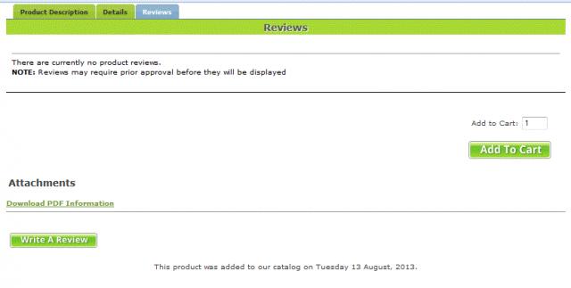

Hello All i am running version 1.5.1
I have Tabbed Products Pro running and it works great :) I have one questions and i haven't been able to figure it out for myself yet - can you create a tab for the PDF attachment MOD
http://www.zen-cart.com/downloads.php?do=file&id=1642 this mod gives you an extra field in admin side which creates a link in the customer side - if possible and its easy i would like to move that link into its own tab. Currently my site looks like attached.
Attachment 12948
Can you create tabs for opther content on the product information page: Yes..
It's simply a matter of taking a look at the custom tab instructions in the read me to determine what code is required to add the tab, then what code is needed to capture your PDF attachments in that tab.. I've no idea what code is required.. only that it's possible to do.
