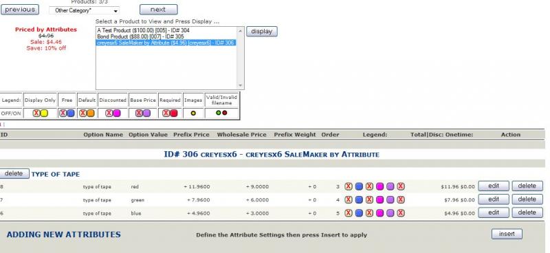

Ok lets get this straight before I start...
From a stock ZenCart install you add products, those products have attributes added and those attributes are going to be on sale using ZenCart's default SaleMaker.
Condition 1:
- 'Product priced by Attribute' must be checked in order to apply the SaleMaker discount to the attributes.

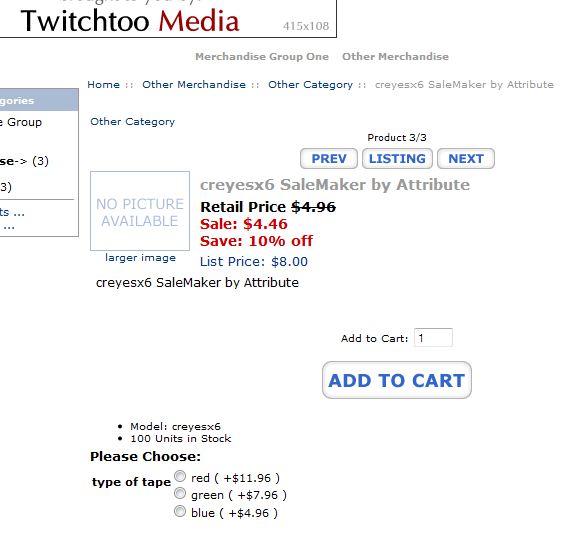

Result 1:
- The product info 'displays' the lowest attribute price with the SaleMaker discounts
like this:
Attachment 13460

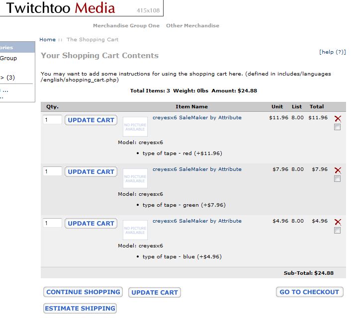

- This value does not get passed to the shopping cart regardless of the attribute chosen:
Attachment 13461
To clarify, the attributes are checked 'yes' to allow specials/sales here:
Attachment 13462

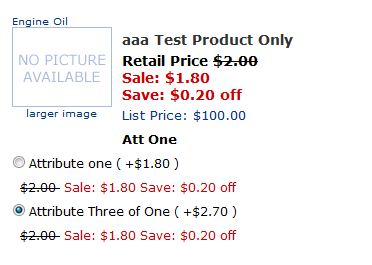

Much thanks to you creyesx6! Good news is on the way...
Re: Display attributes regular price and sale price
creyesx6... you can't imagine how close I am to solving this one...
Attachment 13521
