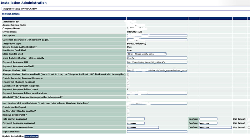

I am having problems with the Worldpay module installed on a customers website.
Bellow are the setup screen from WorldPay admin and an error log from WorldPay for a transaction I ran to test it.
The customer is using Zen Cart 1.5.4 and WorldPay module 3.0
WorldPay worked fine prior to a new build of the website and a move of servers.
I have removed all redirects from the .htaccess file as it seems that the redirect url being presented is different from the one sent. I have also ensured that the site is set as http://www.domain-url.co.uk in both normal configure.php and the one in admin.
Hitting a brick wall with WorldPay as they say that it is a Zen Cart problem. I have also tested the issue with the standard template to ensure there is nothing in the new template causing the issue.
All help will be gratefully appreciated.
I should add, whilst this is a move to a new server, the site is a new build (the customer, orders and products tables were imported to the new database only - all other tables are from the new build).
Attachment 15557
Attachment 15558
