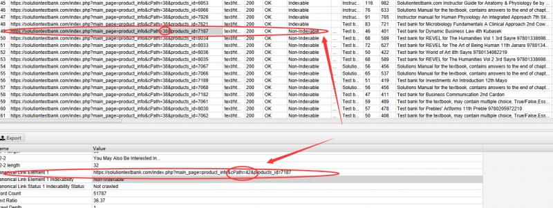

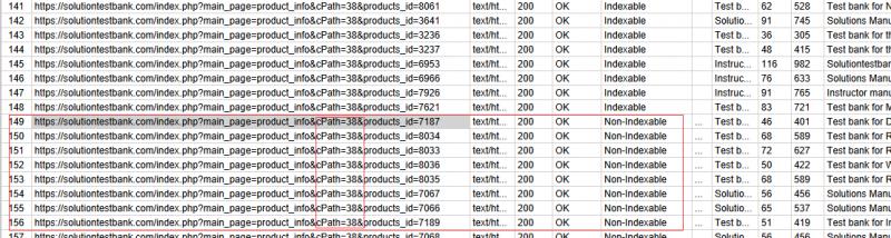

Also, can you please tell me in where I can find the code interface in screaming frog, sorry but I am new to this tool.
Please take a look at the crawl info, in the red area the links in bots eyes are all wrong and not indexable, I don't know how did it happen ,but the canonical link is correct though, see the pictures
Attachment 18449
Attachment 18450

in above screenshots I want bot to crawl a category: https://domain.com/index.php?main_page=index&cPath=38 and there is a 141 products in it.
however, beyond that number, it should automatically adjust the cpath number but instead, it finds wrong urls , how did this happen?
which files in zen cart control this ? do you have any idea?
