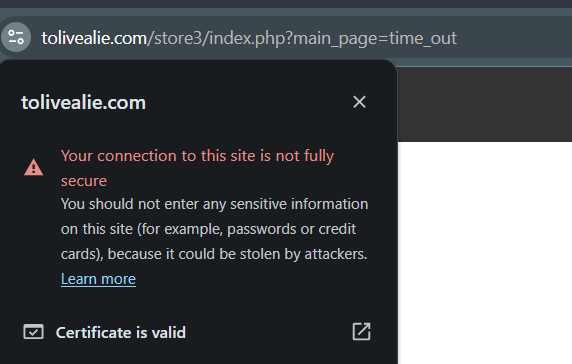

Attachment 20786
Hmm this is super odd, maybe at the root of the problem. If the cert is good, why would this be insecure?
Attachment 20786

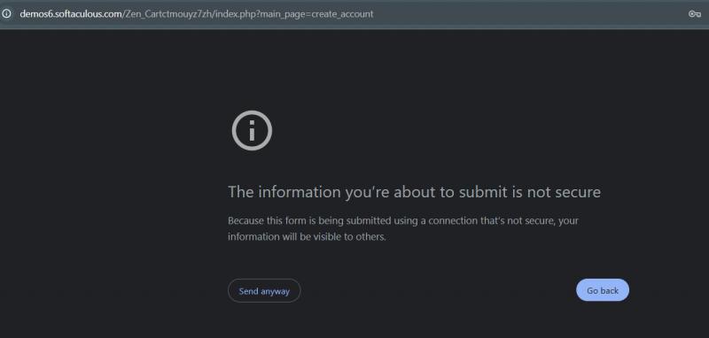

Attachment 20787
I did the built in demo and see the same thing happen there. This feels like this is at my hosts level.
If I'm running PHP 8.1 will this create this insecure error?
It has nothing to do with the PHP version.
Check includes/configure.php and be sure all the URL entries (HTTP_SERVER and HTTPS_SERVER) have values that start with "https://"
They do. And ENABLE_SSL is true. I haven't edited this file since 2020 either so no changes have been done there.
Attachment 20788
For the sake of continuity, this was the same on my reloaded 2.0.1 system (/store2) but not on the Softculuous install (/store3) and I fixed it there but that site is still acting the same.
