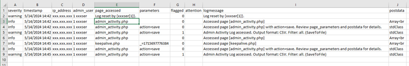

LOGSPHP Code:
$extra_info = email_collect_extra_info($name, $email_address, $account->fields['customers_firstname'] . ' ' . $account->fields['customers_lastname'], $account->fields['customers_email_address'], $account->fields['customers_telephone'], $account->fields['customers_fax']);
// Worked on old installation $extra_info=email_collect_extra_info($name,$email_address, $account->fields['customers_firstname'] . ' ' . $account->fields['customers_lastname'], $account->fields['customers_email_address'], $account->fields['customers_telephone'], $account->fields['customers_fax'], $company, $extrafield, $extrafield2, $street_address, $suburb, $city, $state, $postcode, $extrafield4);
logmessage
Log reset by {xxxxser[1]}.
Accessed page [admin_activity.php]
Accessed page [index.php]
Accessed page [keepalive.php]
Accessed page [admin_activity.php] with action=save. Review page_parameters and postdata for details.
Admin Activity Log accessed. Output format: CSV. Filter: all. (Download to browser)
