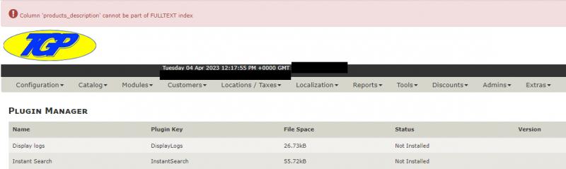

Havin a problem installing this, I get "Column 'products_description' cannot be part of FULLTEXT index" when trying to install the plugin in my store admin, I have also replaced InnoDB with MyISAM in the script installer as detailed above but I get the same error when clicking on install. Is there something I can change in my database using myphpAdmin to fix this?
PHP Version: 7.1.33 (Zend: 3.1.0)
Database Engine: MySQL 5.5.5-10.3.27-MariaDB
Zen Cart 1.5.7c
I hope this is an easy fix as my search is currently non-functioning (I installed on my live store without testing lol)

Thanks for the info Marcopm, i'll remove what i've uploaded and give the older version a go.
