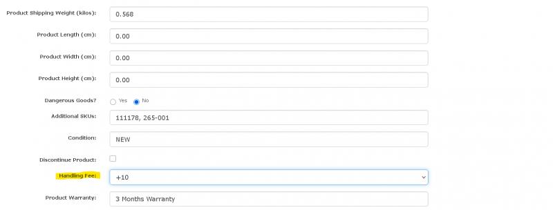

What I have is an old module called handling Fees which I can set a dropdown amount and this works for each indivual product because they are all different sizes and weights.
How it worked in the past was that I would set the handling fee from $1.00 to $21.00 (and I could even set higher amounts) for any product that I wished and it would the overwright the OZ Post module handling fee if it was large amount and if less the OZ post would use its handling fee. Screen shot below.

The only Handling Fees plugin I could find is the one from Numinix "Product Handling Fees - Version: 1.2.3.0". Which is not compatible past PHP 8.1.
I could not get it to run.
Your screen display is totally different as the Numinix version uses 'Handling Fee Groups'.

I will have to get back to you regarding the module because it was modified by a developer some time back so that I could do the handling fee per product rather than a group situation.
The group does not work for me because of different sizes of product and weight etc.

PM the files to me. No guarantees. Is it a plugin or are there modified core files required as well?
