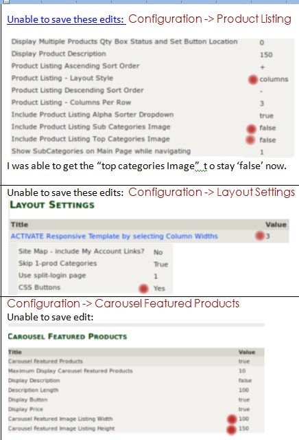

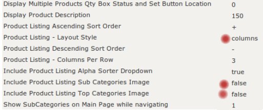

The stirling_grand.sql file has a couple of configuration values that aren't being set properly, given that the "configuration_value" field is a variable-character one. In each case where the value is set to false, the configuration_value is set to 0; when set to true, the result is 1.
UPDATE configuration SET configuration_value = false WHERE configuration_key = 'PRODUCT_LIST_ALPHA_SORTER';
UPDATE configuration SET configuration_value = false WHERE configuration_key = 'PRODUCT_LIST_CATEGORIES_IMAGE_STATUS';
UPDATE configuration SET configuration_value = false WHERE configuration_key = 'PRODUCT_LIST_CATEGORIES_IMAGE_STATUS_TOP';
UPDATE configuration SET configuration_value = 0 WHERE configuration_key = 'PRODUCT_LIST_DESCRIPTION';
UPDATE configuration SET configuration_value = 0 WHERE configuration_key = 'PRODUCT_LIST_FILTER';
UPDATE configuration SET configuration_value = 1 WHERE configuration_key = 'PRODUCT_INFO_CATEGORIES_IMAGE_STATUS';
UPDATE configuration SET configuration_value = true WHERE configuration_key = 'USE_SPLIT_LOGIN_MODE';
The SQL conversion magically handles the numeric inputs, but these "real" character values should be set as:
UPDATE configuration SET configuration_value = 'false' WHERE configuration_key = 'PRODUCT_LIST_ALPHA_SORTER';
UPDATE configuration SET configuration_value = 'false' WHERE configuration_key = 'PRODUCT_LIST_CATEGORIES_IMAGE_STATUS';
UPDATE configuration SET configuration_value = 'false' WHERE configuration_key = 'PRODUCT_LIST_CATEGORIES_IMAGE_STATUS_TOP';
UPDATE configuration SET configuration_value = 'True' WHERE configuration_key = 'USE_SPLIT_LOGIN_MODE';
Note also the initial capitalization for the USE_SPLIT_LOGIN_MODE value.

I'm working on a NEW install of zencart 151 with the Stirling Grand Responsive Template 151real. g i n g e r b r e a d t e a r o o m .com
I'm encountering two issues on the install and I don't see any other posts like this. I'm wondering if I've missed something ....
1) After running the about_us.sql patch, I don't see the "aboutus page status" in the "Configuration -> Define Page Status" area. Saw potentially a post a long time ago about issue with the SQL patch, however I looked at the same patch in the Resposive Blue theme and the coding is the same in the patches.
2) Additionally, "In your Zen Cart admin go to Configuration -> Product Listing" I was working on editing the values shown in the instructions. Several of those values won't 'stick' even though I press the 'update' button. The ones that won't save are:
Attachment 13754

1. Try this:
INSERT INTO `configuration` VALUES ('', 'Define About Us Status', 'DEFINE_ABOUT_US_STATUS', '1', 'Enable the Defined About Us Link/Text?0= Link ON, Define Text OFF1= Link ON, Define Text ON2= Link OFF, Define Text ON3= Link OFF, Define Text OFF', 25, 90, '', '', NULL, 'zen_cfg_select_option(array(''0'', ''1'', ''2'', ''3''),');
2. This is not a template related problem. Check your logs folder for errors.

The code worked, thanks! Now I can see the "about us" to define. Should this be set to 0,1,2, or 3?
For the second issue:
I don't have any error logs that have been created today. The last one I had was yesterday:
"[08-Feb-2014 01:08:42] PHP Warning: htmlspecialchars() [function.htmlspecialchars]: Invalid multibyte sequence in argument in /.../define_pages_editor.php on line 188 "
I compared the "define_pages_editor.php" in the 1.5.1 original package and the one on my site and they are identical in WinMerge. I also had several other places further in the instructions where my edits won't 'update'. Here is the status of what won't keep an 'update'.
Attachment 13759

You can set it to whatever you need.
