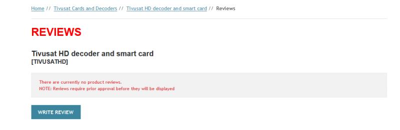

i can write a review, it gets posted but then i'm taken to a funny page, below is the screenshot. basically it should better put a message
thanks for taking time in reviewing bla bla bla.
the other thing i noticed is that even after the review is approved from the admin, the product still shows
be the first to write a review, or similar. so still unusable. any help here?
