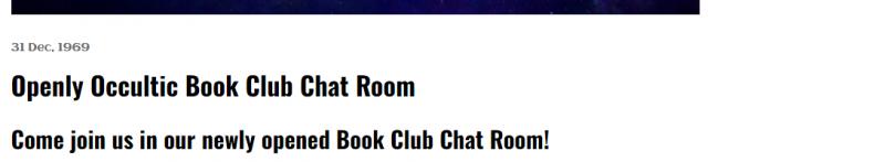

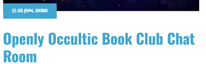

4 Attachment(s)
Re: News Box Manager v3.0.0 [Support Thread]
Greetings!
I'm having a problem or 2 with my newsbox (3.2.0)
1. The date showing for my article is not showing correctly on my homepage nor on my all articles page nor on the article page itself. I'm sending screenshots of the correct date shown in my admin news box manager (all articles) and from the homepage of my site (www.cedargroveherbs.com), all articles page and the article page. The date is correctly shown in my sidebox though (https://www.cedargroveherbs.com/discount_coupon.html)
Attachment 20578Attachment 20579Attachment 20580Attachment 20581
