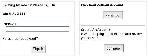

Hi first of all this is a great mod and I hope this will be a standard integration in zen cart in the future.
I'd like to modify the split login page so that the COWOA floating box stands on top with the original split login boxes underneath. Any idea can I modify this in tpl_login_default page without messing up the Paypal layout?
J_Schilz,
Hey that sucks about your name. There should be a way to change that as long as you are in good standings but I can see reasons why not.

Hi Joe,
You were right. I guess. Probably the mod was working fine and it did not appear because I did not have anything in the shopping cart. I reinstalled everything and it works very well.
I have two suggestions (I think someone already asked though and I will pretend I do not know).
I would like the check without account option to appear before the other two (now it sits below the create account box).
Also I really believe the 5 steps are too long. It would be enough to combine the billing and shipping info in the same page with a box to be checked if the shipping address is the same as the billing address.
Would it be a major change to implement? I'd rather not use other people's mods to shorten the checkout: too many cooks in the kitchen...
Thank you for the great work, your mod was needed and works great.
vatel,
After stepping back from this for a bit, I think you and others are correct about the proper placement of the COWOA option. It's a pretty simple matter and I'll go ahead and hit it this weekend.
As for your other suggestion, I think it's reasonable. Although, one thing to keep in mind is that it's only 4 steps, really. There's this "Your Done" 5th step to keep the customer from think they're done once they reach step 4.
At any rate, I don't think I'll be implementing a reduction in steps. I've posted my thoughts on the matter before. But, I do encourage people to customize this however they like and to share the results. I could even link them from the wiki, to provide a bit of centralization.
Sorry I can't address all of your issues. I will, however, move the COWOA box on split-login checkout this weekend. This should be a simple template replacement for those who already have it installed. If you've got too much customization for a template replacement let me know and I'll provide instructions.
--Joe

I finally installed this on my test site, and it's running great! Thanks guys!!!
I modified the login page so that COWOA option is at the top left. Please feel free to use it. Rename the attached file to tpl_login_default.php, and uploaded to includes\templates\YOUR_TEMPLATE\templates directory.
Note: I used the split panel login option (1.3.7), which, IMO, looks a bit nicer than the normal login option. You can turn it on in Admin - Configuration - Layout Settings - Use split-login page. Or, you can modify the template I provided so that there's no "if-then" statement for split or normal, and delete the normal login stuff. LMK if anyone needs help.
ETA: You'll need to make changes to your language file.

Alright, sorry for the delay guys. I've got the box moved to the top, as you can see in the new screen shot:
Shot 1
I've repackaged the new layout into the zip, but it's just a matter of replacing two files.
includes/languages/english/your_template/login.php
includes/templates/your_template/templates/tpl_login_default.php
login.php
Of course, if you've already customized either of these files files then it isn't just a simple overwrite...unless you want to lose your changes. Let me know if you need any help and I can give more detailed instructions.
Oh, I also felt like the header needed changing from "Welcome, Please Login," since logging in is no longer the main emphasis. But, I don't think "Welcome, Please Choose How to Proceed" is that great either. Looking for any ideas. Mind the fact of course that both 'Login' and 'Checkout' link to the page.
--Joe
