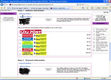

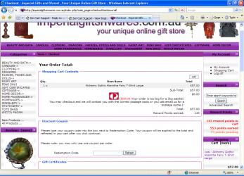

Thanks for the icon links I shall be using those, I have attached (if it works) the top and bottom screenshot when checking out the top one you can see the error and then at the bottom of the screen the customer can choose the correct postage. It doesn't change if you put the postcode in before hitting go to checkout
