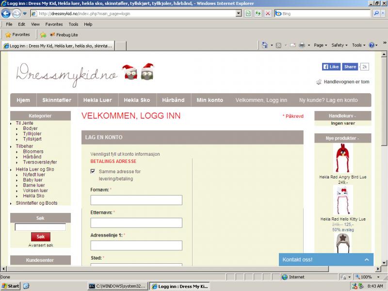

Hi.
I have a problem with the login page in some browsers, for example Internet Explorer 8 on Windows XP. Only the half of the create account shows and the login is not visible at all.
It's works very well in other browsers.
See screenshot. Tips?
Attachment 14724

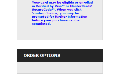

For some reason, I cannot get Store Pickup to stay selected on final order total before confirming the order. I have a fresh install, and I am not live yet because I am working through all my issues and custom configurations first. I am doing all test orders for different customer scenarios. However, I can not get Store Pickup to stay selected on the final checkout page before confirming. It shows up as a possible shipping selection on Checkout Step 2 of 3 page with the other selection Flat Rate. It always defaults to Flat Rate. It never defaults to Store Pickup. I can select Store Pickup as the chosen radio button, but then when I click Continue and go to Checkout 3 of 3 page, it switches to Flat Rate. I cannot get it to stay on Store Pickup! This is not good, because some customers will not want shipping at all and want to pick up their products at the store. At this rate, I am not able to know if they want Store Pickup, just looking at their checkout results. Am I doing something wrong in the setup of the products or shipping modules, or configuration settings? I have no idea where to start digging to look for the solution to this problem. I have Stirling Grand template and Fast and Easy Checkout installed. I am using the latest ZC version 1.5.3. In Modules > Order Total > Shipping, I have Shipping set to "Free shipping for orders over $100". But that does not seem to affect anything. I am testing with orders way under $100, and it still does not work properly. I can let you know any more configuration settings that you need to know, and also let you look at my store site. Please help!
I would like to go live with a more up to date version of Zencart but the reason it has sat around for so long is that I have a couple of Fast and Easy Checkout Issues on the checkout page.
1) The edit button appears in the wrong position on the page. Is it possible to move it to a better position within the box ?
2) How can I remove the Order Options Box. As it is empty and I dont know what it is used for.

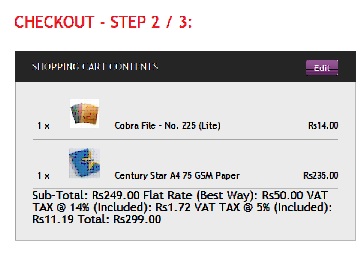

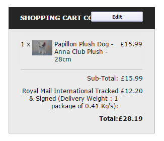

A happy new year to all users!
I have installed FEC 1.15.3 on Zencart 1.5.3 on Tableau Reponsive template.
Everything is working nicely except the Order total alignment on Checkout page 2.
Attachment 14822
I need to arrange this properly.
Please help!

I have finally got fast easy checkout working ,well about 95% ... On Checkout - step 2 / 3 the edit button on Shopping Cart Contents is sitting right over Cart Contents
and hiding the words ,is there a way to move this. If you want to take a look pewterworld .co .uk you will need a account [email protected] pas is 1111111111 (10 number ones)
The 2nd issue is rather worse.We had it working once then had issues and went back to backup database since then the admin side has not updated I tried un-installing it and found out it would not install again ... I replaced the database from a backup again the updates ran fine as I saw it happen but it did not update to the new style .. Is this OK to leave as it is or is it better to update it
Hi All
having trouble with the styling on this module.
All the admin stuff seems to have installed correctly.
I have checked the pages that are being loaded when going through checkout and the FEC pages are being loaded.
However none of the default styling is being loaded, its just the bog standard log in styles that are being loaded.
Also when i change the page to plit login nothing seems to happen?
Just one long page of login details to fill in.

I need a bit of help. My order total is not showing up completely. What i mean by that is that the last number is partially cut off.
My site is missingcord.com. I had another crash and i am trying to get everything back up. I had fast and easy checkout working before so i don't know whats wrong. This is a fresh install of zencart and FEC.
My zen cart version is 1.5.3 and i am using Fec 1.15.3.
I have added a photo of the problem.Attachment 15113

Not a payment issue at all. Its the way it looks in mobile that is the issue.
Mobile side of fec is squished In portrait mode and useable in landscapeonly.
Any ideas. Thanks for the help.
Here is a screenshot of how it looks
Attachment 15240
