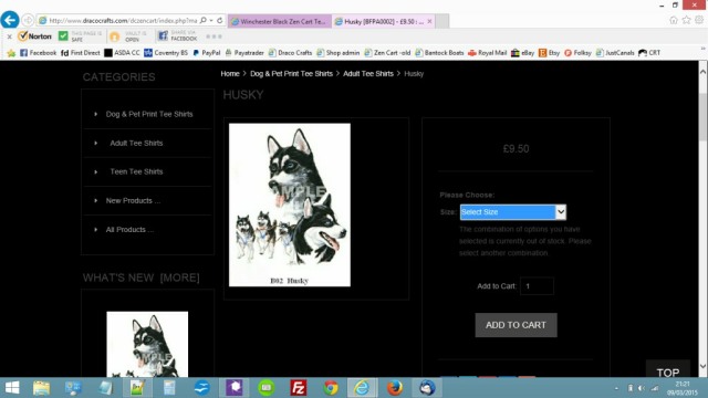

Hi all, I'm back with a couple more questions...... I am now using Zen Cart 1.5.4. and have installed the above version of SBA (https://github.com/potteryhouse/stoc...12345678_ZC154). Everything is working as far as the setting of attributes is concerned and even the glitch I had with the previous version has been resolved regarding zero quantities. However, I do have a couple of issues, both of which may well be down to me missing some settings I am sure, but I seem unable to resolve either.

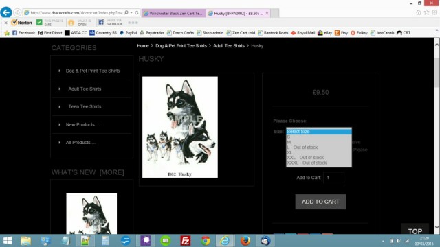

The first issue, is that although I have the setting in 'Configuration/Stock/SBA Show Stock Level on Product Info Page' set to 'true', the quantities are not showing in the drop-down list, as shown on the screen dump attached.
Secondly, on the product info screen, even though some of the options have stock (and in this case there is only one option anyway) the following text is permanently displayed: 'The combination of options you have selected is currently out of stock. Please select another combination.', as shown on the second attached screen dump.
Any advice, help or even just telling me I am twit and change this and that setting, will be gladly received :P
Mike
Attachment 15045
Attachment 15046
I need to modify the default installation script a little, but if you goto configuration-> Dynamic Dropdowns and turn of the single attribute option, the issue described (for single attributes) will go away. :)
Ie, the default programming you are used to seeing will return.
