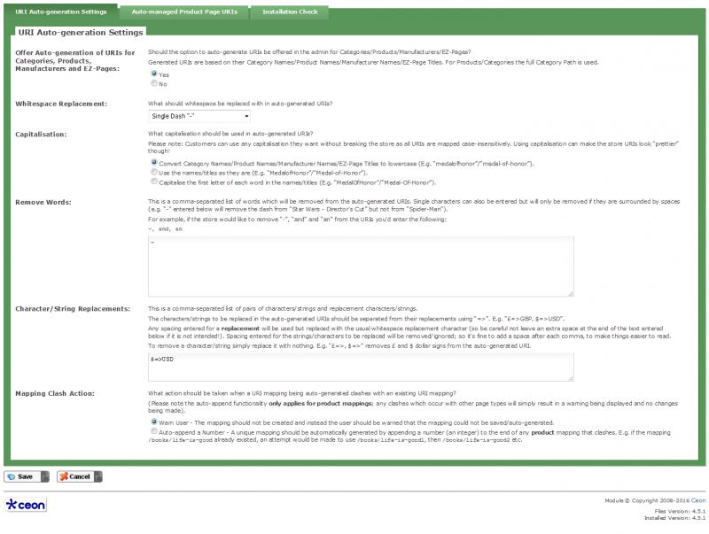

Hi All,
Have just had the latest version of Ceon URI Mapping 4.5.1 installed on zencart version 1.5.4 and have an issue with dashboard not showing the all the tabs as shown below:
Attachment 16559
Note that it is missing the other tabs which are in image below:
Attachment 16560
Can someone tell me how this can be corrected as I want to be able to use the feature that updates all the URI on the site. At present I have to go into each item in order to generate the URI mapping and as I have over 24,000 products this would take some time to do.
