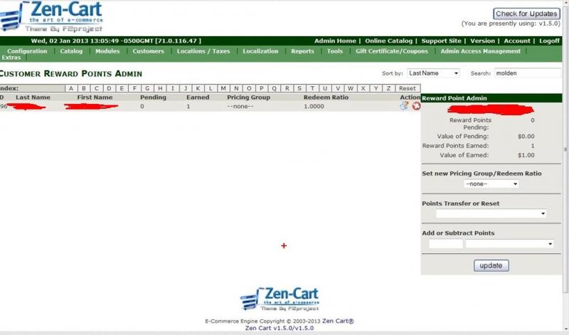

I get 1 point for $10, but the admin/customer/Reward Points:
I see:
Reward Points Earned: 1
Value of Earned: $0.10
The "Value of Earned" is not right. It should be $1.00, not $0.10. May I know which setting affect the value of earned ?
If you set the Reward Points up like I mention, you will get the results I stated.
When I go to admin/customer/Reward Points: I get what you see in the picture down below.
I'm not sure what you did to get a "Value of Earned"
Attachment 11700
Go back and check the setting to make sure they are set up right.
The setting I have is for every $10.00 a customer spends they receive 1 Reward Point worth $1.00
