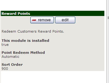

i just installed but i couldnt find how to edit the redeem ratio.
I only see this in my order total moduleAttachment 11806
hope someone can help me :)

juneloweelyn
Attachment 11806
You have to go to admin/configurations/Reward Points and set up all setting to your liking.

countrycharm
Which is explained in the readme file for this module..

DivaVocals
I already did :) but i couldnt find where to adjust the redeem ratio.
in the read me, it says i can adjust it in modules >order total > rewards point
But i cant seem to find it, hope u can help me
