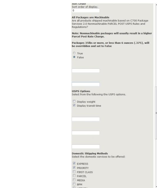

Re: USPS RateV4, IntlRateV2 support and etc..
I installed everything and ran the SQL, the admin shows blank field but have no indication/description where the dimensional configuration should go to. Can anyone help?
Attachment 11382
