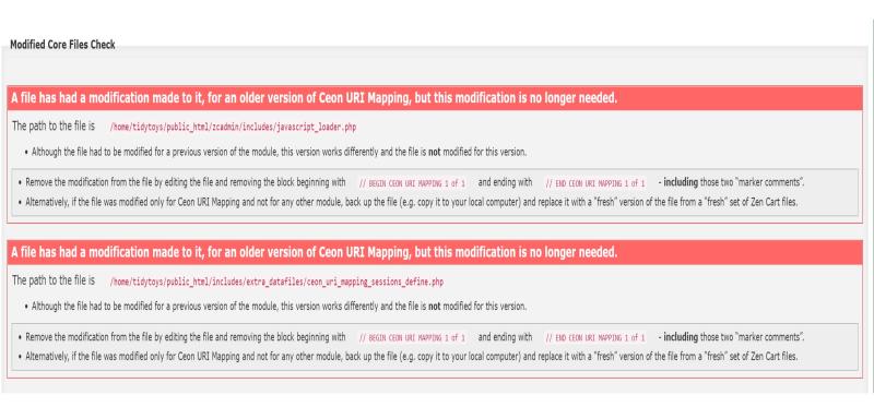

Put my website live v157 using ceon uri mapping v5.0.0 ... then panic, realised that there was a later version ... so updated to the latest version of ceon v.5.1.0
But Ive got 2 installation errors ...
Found the code to delete in admin/includes/javascript_loader.php ... however deleting this piece of coding means that the place to add your url in on the product page disappears. Is this correct ?
The other error I cant find mention of the code to remove.
Attachment 19814

To me, looks like haven't completed the upgrade instructions of the docs (going from 5.0.0 to 5.1.0). When looking at the instructions, along the top is an upgrading section/area:
_docs/sections/upgrading.html
Then, based on what is said above, upgrading from 5.0.0 to 5.1.0, would then go to that section/area:
_docs/sections/upgrading.html#upgrading-from-version-5-0-x
Then scroll down a little which will help address the above two issues. Look below the "Updated files for the main site directory" there is a section that looks like is applicable to Zen Cart 1.5.7. It seems to indicate that need to add some files and then further below that is to delete a file (if I understand correctly it appears to say when installing to Zen Cart 1.3.9c and above): includes/extra_datafiles/ceon_uri_mapping_sessions_define.php
that file appears to be one of the files referenced in the previous image...
All that said, though interestingly as I look through the installation portion of the instructions (had this truly been an initial install) then it looks like the step to include the 1.5.7 related file(s) is missing from the instruction. That's a shame for users brand new to using the software on Zen Cart 1.5.7 if initially downloaded from their site.

Thank you for your reply.
I put my website into live then realised that I didnt have the latest version of this module. So was in a bit of a panic.
(Its the 2nd plugin where I had installed the wrong version, the latest being held outside this forum)
Ive deleted includes/extra_datafiles/ceon_url_mapping_sessions_define.php
I dont know what to do with zcadmin/includes/javascript_loader.php as when I delete the lines it refers to ... I lose the ability to modify my filename in the products admin page. Although the installation warning message goes away.
Surely the whole point of the module is to edit your filenames.
I also have a log error message.
[17-Nov-2021 09:33:52 Europe/London] PHP Fatal error: Call to a member function collectInfoBuildURIMappingForm() on null in /zcadmin/includes/ceon_uri_mapping_javascript.php on line 24
[17-Nov-2021 09:33:52 Europe/London] Request URI: /zcadmin/index.php?cmd=product&page=1&cPath=199&pID=2267&action=new_product, IP address: 2.127.66.203
--> PHP Fatal error: Call to a member function collectInfoBuildURIMappingForm() on null in /zcadmin/includes/ceon_uri_mapping_javascript.php on line 24.

Your lines 23-24 of admin/includes/ceon_uri_mapping_javascript.php are they:
$languages = zen_get_languages();
echo json_encode(utf8_encode($ceon_uri_mapping_admin->collectInfoBuildURIMappingForm())); ?>;
or is there this content inserted between those two lines?:
if (empty($ceon_uri_mapping_admin) || !is_object($ceon_uri_mapping_admin)) {
if (!class_exists('CeonURIMappingAdminProductPages')) {
require_once(DIR_WS_CLASSES . 'class.CeonURIMappingAdminProductPages.php');
$ceon_uri_mapping_admin = empty($GLOBALS['ceon_uri_mapping_admin']) ? new CeonURIMappingAdminProductPages() : $GLOBALS['ceon_uri_mapping_admin'];
If the second code snippet above is not included in the store's fileset, then the files are not up-to-date with 5.1.0. This file was one of the files that was to be updated for 5.1.0. Further, if that file didn't get updated, then one would question what other files didn't get updated on the server.
