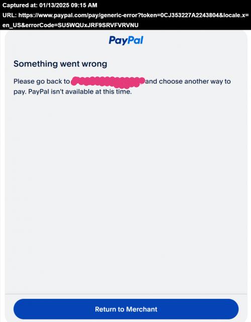

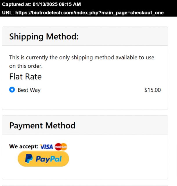

I didn't, see below
Attachment 20866
Attachment 20864
Re: PayPal RESTful API Payment Module
@mprough, is there any more to that paypalr log than what you posted? If so, please post as I don't have sufficient information to investigate the root-cause of the issue.

Chrome fully up to date, some dev plugins like measure it & color picker
BUT, I have other client's websites same version everything with no issue. Same server. Only difference I can see is this one does not use credit cards, only PP.
I can use PayPal today, tested, same PP version 1.0.5, ZC 2.1.0 & same server. successful

You have the link, want to try & see if you can get to PP? The error at PP is just after login
