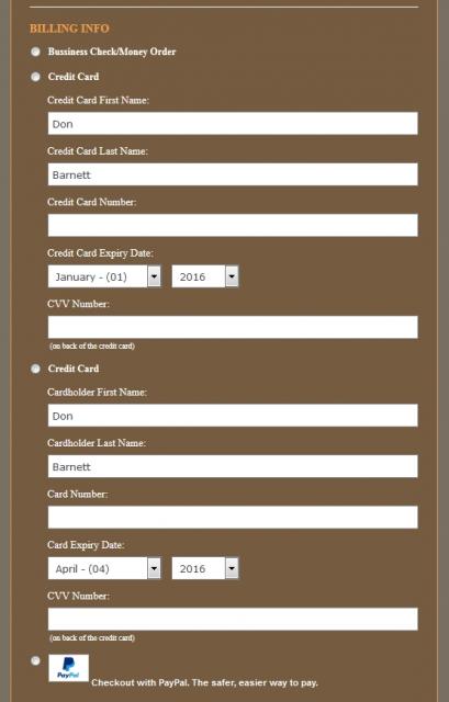

On my checkout page it gives 4 options for payment
1 Busness check
2 Credit Card
3 Credit Card
4 Pay Pal
If the customer trys to use the 1st credit card option it will fail with "The credit card number must be at least 10 characters." regardless of what value are entered.
If they use the 2nd credit card option it works.
How do I get rid of the 1 option? Where do I find the code? All my modifications are in classic folders.
Here is a image of the screen I am talking about.
Thanks for your help.
Attachment 16249

doveman,
i would start by looking in the admin, Modules -> Payment and see how many payment modules are enabled.
if only three, then you have a problem with your implementation of this add-on or your template.
it sounds like the reason why you are getting that error no matter what you type in the first credit card number is because the error checking is only checking the second CC number. so you will never error out on the first. and the question is also whether it is a jquery/javascript error or a server side error.
there are many things that could be going adrift here.
good luck!

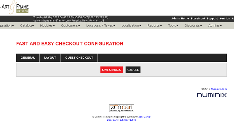

I'm using 1.5.5 and having trouble installing the Fast and Easy Checkout. I've already installed the CSS/JS loader. It's set to false for both minify options.
I get the blank screen when I go to the Fast and Easy screen with just the "General" "Layout" and "Guest Checkout" with Save and cancel below it. No options and nothing when I click on the boxes. I've tried the uninstall suggestion, and I've also attempted a second install on a clean version of 1.5.5. Nothing has worked.

I started out with a fresh copy of my site on the server. I uploaded CSS/JS Loader to my site then uploaded FEC plugin. Still does not work
In the admin/configuration/fast and easy checkout, the 3 tabs (general | layout | guest checkout) are not functional. There are no debug files on the logs folder.
My Site: http://www d o t maynardstackle.com / zencart155e / zencart155e/
any ideas would be appreciated.

Re: Fast and Easy Checkout for Zen Cart
*Edit to last post*
Attachment 17824
This is the only thing I get when I go to the config page.
