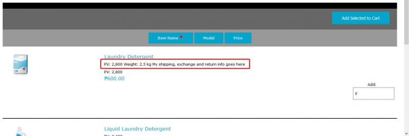

Re: Tabbed Products Pro (TPP) Contrib - Official Thread
I am using zc version 1.5.5a
I have two questions...
1) How can I remove product description information on the product listing page.
here is my Product Description text
<!--%Product Description%-->
<div align="center" style="padding-top:20px;">
<div align="center" style="max-width:900px;"><img src="/store/Products/00821-a.jpg" /></div>
<div align="center" style="max-width:900px;padding-top:40px;"><img src="/store/Products/00821-b.jpg" /></div>
<div align="center" style="max-width:900px;padding-top:40px;"><img src="/store/Products/00821-c.jpg" /></div>
<div align="center" style="max-width:900px;padding-top:40px;"><img src="/store/Products/00821-d.jpg" /></div>
<div align="center" style="max-width:900px;padding-top:40px;"><img src="/store/Products/00821-e.jpg" /></div>
<!--*sub_AddToCart(1)*-->
<!--%Details%-->
<div style="padding:20px 0 20px 0; font-size:16px; font-weight:bold;">
PV: 2,800<br>
Weight: 2.5 kg
<!--%Shipping/Exchange/Return%-->
<div style="padding:20px 0 20px 0;">
My shipping, exchange and return info goes here
<!--@EndTabs@-->
The information in "Details" and "Shipping/Exchange/Return" is showing on the product list page.
Attachment 16542

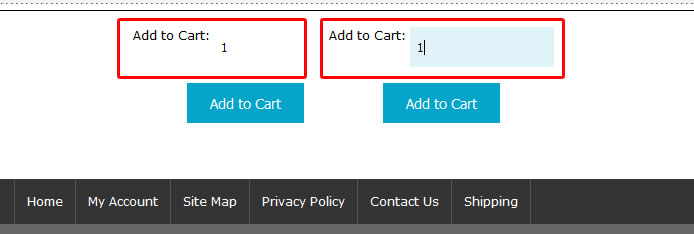

2) How can I change the look of the "Add to Cart" quantity box? I want to put a black border around it. Below are two pics.
This is the current look (I have outlined the area in question with a red box). Left is original state and right is after clicking inside the box.

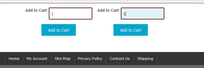

Attachment 16543
This what I want it to look like. again... Left is original state and right is after clicking inside the box.
I found the answer to question #1 :D
and I removed this line... <!--*sub_AddToCart(1)*-->
I found it wasn't necessary. "Add to Cart" is at the bottom of every tab.
Now I just need to change the look of the quantity boxes.
Kuya
You should post this as a new question in the forum as it's more of a template/CSS change, and NOT a TPP specific solution..
