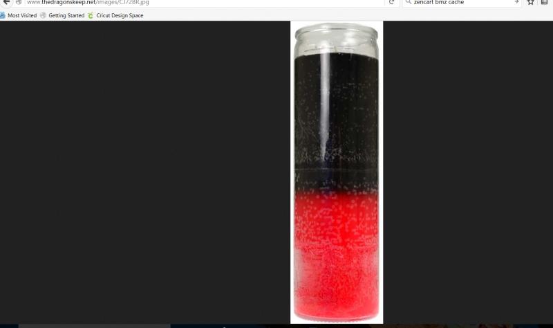

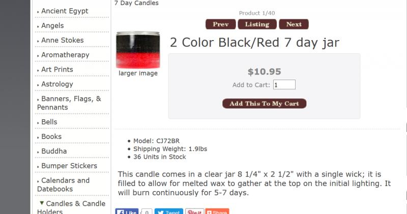

Attachment 16047
If I right click and click view image full image then shows. Attachment 16048
So confusing.
