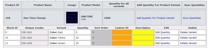

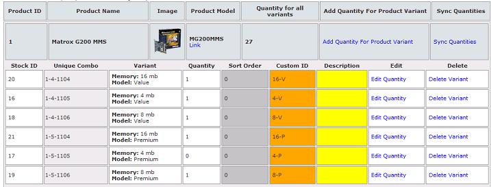

So I haven't attempted to duplicate the scenario specifically to see if this is the case, but below should be two images showing the two different scenarios to which I speak. They are created by different means on the front end in the admin. The first is as described many attributes each with their own stock. The second is many attributes combined as individual variant "products" each combination of attributes having a single quantity of availability.
Attachment 15337
Attachment 15338
