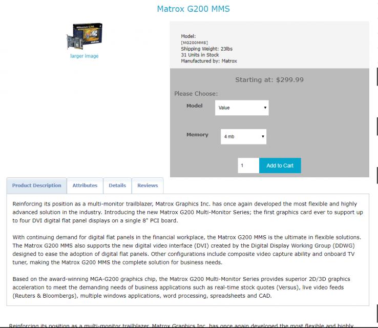

Tried again. The instructions indicae to change the a cc's file. Done that. Changed custom tab 1 & 2 to another heading. Followed the steps to add relevant information in the product description, but on live site no tabs.

Very nice plug-in but I'm having problem understanding the adding of a tab and the purpose of the custom tab 1, 2, 3. I want to have a tab that says " Shipping & Returns" this will be a global tab I copied the text from my ezpage and then added it to the custom 2 tab. How do I changed the name on the custom tab?
I know this is easy and I am somehow not understanding the instructions.

I installed this on a development site ZC 155f and and TPP 1.2
It looks and works great, but I came across a weird limitation. I didn't see any mention of this in the docs or in the forum... sorry if this has been discussed before.
There seems to be a hard limit to the amount of text that can be added to each tab.
I had longish product descriptions, and this caused a close div tag </div> to be inserted in the html on the product list page. With the result that the page stopped loading.
The product description pages were working fine, which made this hard to track down.
If I moved one paragraph to another tab, problem solved.
