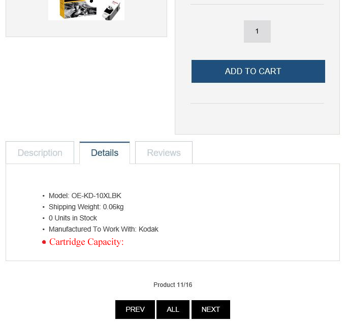

I know this is over 2 years old but here is my situation.
I'm running the latest Zen Cart and using the Responsive Sheffield Blue template.
I have successfully imported 10,000 products into my database of my new site and have it laid out well thanks to this community. I have used EP4 to import the data and have set my options in EP4 to include a user defined product field and I have imported the data I want to that field, that it working fine.
What I would like is to include this data (if possible) in the details tab like this ...
Attachment 17254
Obviously not in red LOL. After the : I would like it to get the data from the new field in the products table, the extra field is ink_ml and as said before already has the data relevant to the product.
I have followed this thread that was done back in 2015 by crazy_chris but ended up with an error on the product page so I`m not sure if anything has changed since that was written. Has anyone done a step by step guide to achieve this ??
