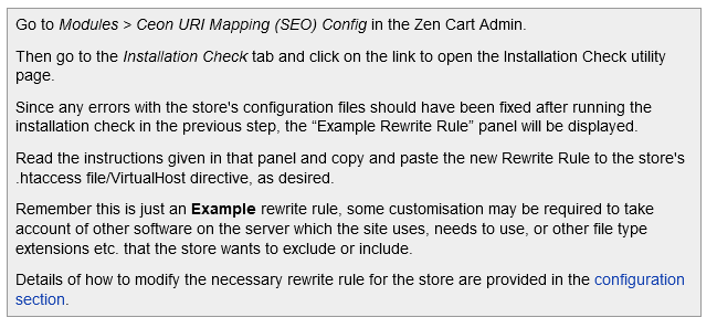

reading the faq for installation and configuration, I have not seen changes for the htaccess file, and it is not present in the plug-in files,
is it generated automatically or are there very specific rules to put?
Yes, the htaccess is generated for you. The docs call it an 'Example rewrite rule' but I found that it worked without needing to make any changes to it. Here's the relevant part from the Docs
Attachment 20097
