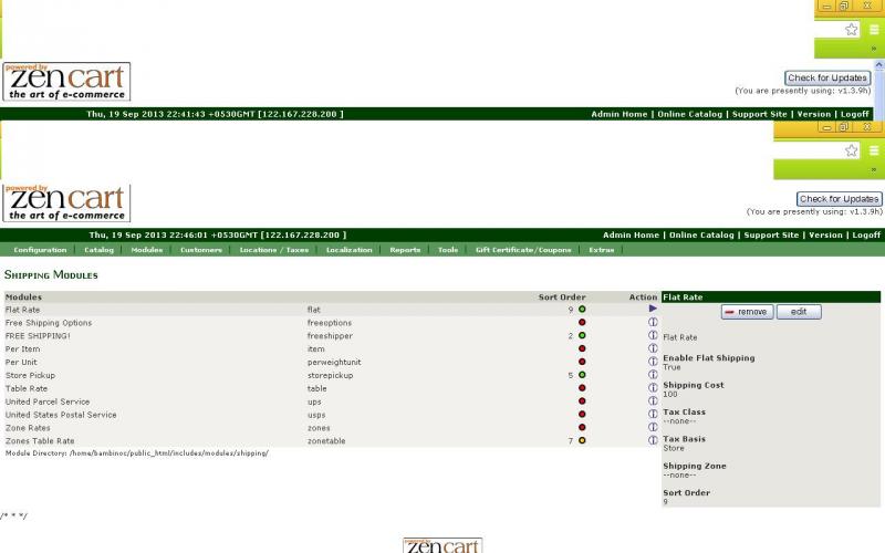

Done, as per your advice. The shipping screen looks as : Attachment 13097

You still have some Sort Orders set to 0 and others defined ...
Either set them ALL to 0 or give them ALL a unique Sort Order ...

I am talking about the Modules ... Shipping ...
You are showing some shipping modules with a Sort Order of 0 and some shipping modules with a defined Sort Order ... you need to *either* have ALL shipping modules set to 0 or ALL shipping modules with a unique, non-zero value ...

I have changed the sort order to have unique sort order for each method.
here's the screen shot :Attachment 13099
Your Flat Rate flat shipping module still reads 0 ... they ALL need to either be 0 or ALL need to have an unique Sort Order ...
If you want to set a unique shipping cost for each of your 4 Zones, then you need to make 4 Zone Definitions with DETAILS setup for each one ...
Then, after your Zone Definitions are created, you need for the Zone Table Rate zonetable to do a REMOVE, INSTALL and re-configure with your Zone Definitions ...
