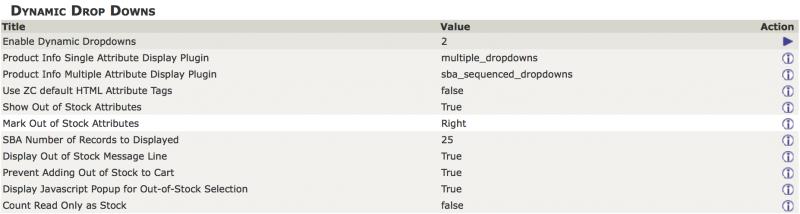

What about the dynamic dropdown settings and stock configuration settings?
(please *continue* to remember to *not* include the admin directory path)
Here are those configurations for your consideration.
Attachment 17216Attachment 17215
