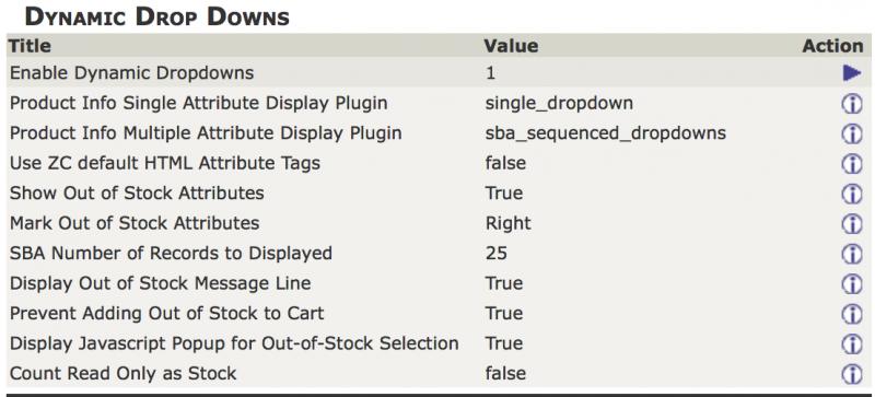

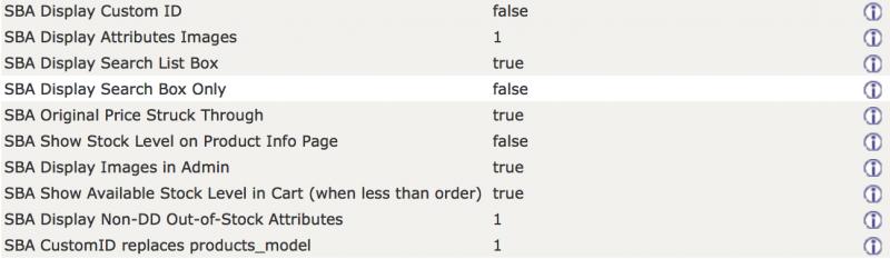

I think I am getting close with my SBA implementation, but I currently don't see attributes on some products in the shopping cart page and I wonder if you have some insights. I have other mods that may be affecting this page as well.
Products with zero or two option names associated seem fine, but products with one option name show up in the cart without their attributes listed. For example this product:
https://www.tokyopenshop.com/shop2/m...cil-p-624.html
I believe this "if" is failing in the tpl_shopping_cart_default.php file in my template
if (isset($product['attributes']) && is_array($product['attributes'])) {
Here are my current settings that I think might be relevant to SBA:
Attachment 17260Attachment 17259
Thanks in advance for any help!

If this is something you are trying to resolve about your install could you please provide some more information? Last that I spoke with fbroz about his install once the default settings for stock (as modified by SBA) and Dynamic Dropdowns (located either one above or one below the configuration->stock option. Trust me when I say it seems almost invisible even when it is blindly there.
There may be an issue though as a result of having installed the original version of it followed by how SBA follows up, I'm not sure. If it isn't there (seriously look really hard and carefully) then we'll talk about what is needed to resolve.
