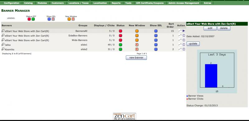

Here we go - Attachment 11765Attachment 11764

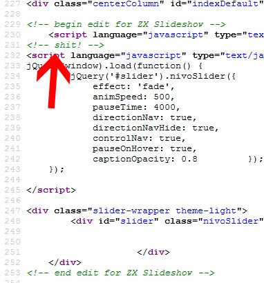

Here's a screenshot for further explanation... :smile:
Attachment 11766
:laugh: yea, you got me. I was trying to see if the file gets loaded at all... I could search for nivo or whatever other word, but didn't think about it until I found the word I inserted. I expected to find javascript from the head, and when I didn't I had to see what was loaded. So anyway, I wouldn't make any changes to any files if it would work at the first place. No doubt that you have done a good job with this plugin. I just wanted to find out why it is not working in my case... I'll let you know if I'll find out. :)

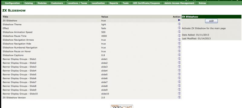

Where is the dimension of images on latest sql?
Attachment 11797
