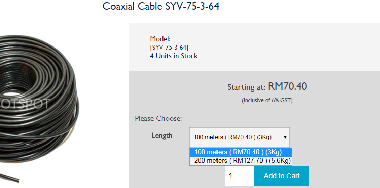

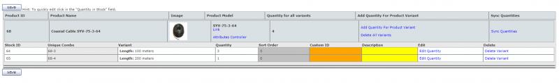

Hi all,
I am new to 1.55e, just did a fresh install and i cant seems to find the option to display stock level on the attribute
Attachment 17359
Already did the options for
Config > Product type > General > Show Quantity in Stock = 1
Config > Stock > Show Quantity in Stock > true
Attachment 17360
Sync'ed a few times already but still not showing :(
Anyone could give me some tips on where should i start looking? Thank you!

For single attribute product/option names like shown above, the option name type needs to be modified to the newly added (new to your ZC) SBA Basic select (dropdown) either through the option name manager or thanks to the support of fbroz through one of the two scripts in the configuration section.
If that has already been done, there should also be a setting in configuration->Stock: SBA Show Stock Level on Product Info Page which is really the option of concern because it operates independent of the display of the total product count.
Thank you MC, you solved my problem! Yes the SBA Basic select (dropdown)!!
