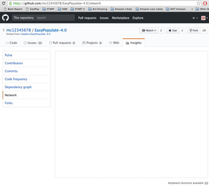

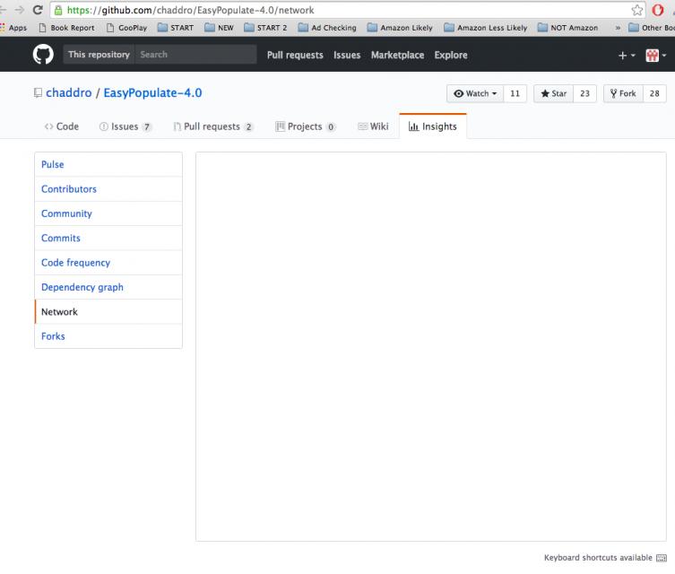

Second, I tried to check out Insights->Network but found nothing there. Thought maybe it was because I was looking at your fork, so I backed up and checked the other fork, still no dice.
Feznizzle
First, HUGE THANKS! Awesome as always, thanks MC.

I guess I'll let the Insights->Network go? I thought you guys were working on "other feature modifications and changes being applied" and you were inviting me to take a look at the plan. To see it, I was supposed to go to the github page for Easypop, click on Insights, then click on Network.
I did that, but found nothing and/or did not understand what I was looking at.
Here are two screenshots to show you what I could see:
Attachment 17465
Attachment 17466
Unfortunately the "map" of the network didn't come through on those screen shots, but the previous links took me to where I expected you to be and I would guess the lack of the map image is something related to github and screen capture. Regardless, yes the thought was to offer a sort of way to see the upcoming direction(s) of the plugin. Each dot on the line represents a saved change. There is a description that displays when hovering over the dot. Clicking on the dot opens a new window and takes you to the specific commit (change) that was made where you can see both the description, any comments, and the specific code changes to support that change.
