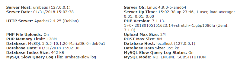

Test install of ZenCart upgrade from 1.5.1 to 1.5.4. on linux with SBA from github - using Stock_By_Attributes_Combined-master, file: 1_5_3 and 1_5_4
Can only work on this in our offseason so into it now for almost a year with a multitude of mods all working but SBA and numinex extra fields
Question: is there a sql statement I am missing for SBA? I can not see the SBA in the admin.
Question 2: am I using the correct file of 1_5_3 and 1_5_4 for ZenCart 1.5.4?
Thanks everyone for working on this mod. Our upgrades of zencart depend on it working. I've always had to tweak it so much... hoping progress is steady and sure.
athena
To be sure all in place: All SBA installs require the initial includes and admin directories (in an approaching change will be restructuring the file folders to make this easier to understand just by looking at the fileset). To further incorporate the software into the applicable ZC version then the applicable ZC version directory is used/merged (i.e. 1_5_3 and 1_5_4 to support installation to ZC 1.5.4).
Working in this sequence, there is no disruption to site operation during installation.
As to the absence of any SBA related items on the admin side, after all applicable files have been placed installation requires execution/access of the admin file: stock_by_attr_install.php (ie. YOUR_DOMAIN_NAME/YOUR_CATALOG_DIRECTORY/YOUR_ADMIN_DIRECTORY/stock_by_attr_install.php)
So any one or combination of the below could be the cause:
1. Depending also on the install/upgrade path/method the applicable files may not have been placed,
2. the database may not have yet been transferred to have the old "connection" to the install, or
3. the install has not been accessed with the currently loaded database in place.

This is a fresh install of ZenCart 1.5.5f. I just built this web server and it has the latest stable releases to my knowledge. I'm on Debian 9. This is my Server info from my admin.
Attachment 17675
I have Categories center box for index page, COWOA, One page, Dynamic Price Update, Debug backstrace, and my payment/shipping modules installed.
I keep getting this error when I try to run the install script:
[31-Jan-2018 14:42:28 UTC] Request URI: /MY_ADMIN/stock_by_attr_install.php?selectSBAinstall=installAll&getSBAinstallPage=Run+Scri pt, IP address: 173.8.96.194
#1 trigger_error() called at [/var/www/clients/client0/web1/web/includes/classes/db/mysql/query_factory.php:171]
#2 queryFactory->show_error() called at [/var/www/clients/client0/web1/web/includes/classes/db/mysql/query_factory.php:143]
#3 queryFactory->set_error() called at [/var/www/clients/client0/web1/web/includes/classes/db/mysql/query_factory.php:270]

Is it a MySQL/MariaDB issue? if so how can I remedy it?

More than likely the key that is causing the issue on the current system configuration is:
UNIQUE KEY `idx_products_id_stock_attributes` (`products_id`,`stock_attributes`),
as a result of stock_attributes being 255 characters (~765 Bytes) combined with products_id being an integer (4 Bytes) puts the key over the 767 Bytes limit by 2 bytes (when using utf8, if using utf8mb4, then well the result is 1020 Bytes instead of the 767).
So to correct this condition, there are a couple of things that could be done, possibly the most "flexible" is to modify the table definition such that the varchar related fields have a small enough size that the database could eventually be transitioned to utf8mb4 (if not already) and support continuing to have the unique keys identified above. (As a result of this notification may need to rethink that assignment of a unique key anyways. The code tends to prevent two or more entries from clashing at least for that particular entry, so it may not even be necessary, but would only suggest that after additional review).
There are some settings that can be applied if the mySql version were 5.6 or above and MariaDb 10.0 and above; however, in trying to keep things applicable to more systems, a more appropriate solution (to address the key issue only) would be one that supports continuing having the key and potential future use of utf8mb4 to do this, I would suggest changing:

Now, that does have a potential impact on the combination(s) of attributes as the code is currently written. The number (integer) that is generated for each option name/option value combination is stored as text and when more than one such attribute is identified then the next pair is also stored with a comma between. Therefore if an attribute_id were to approach the "upper" limit of 2147483647 or 4294967295 (if the number is stored unsigned) then that one attribute alone takes 10 characters adding an additional attribute would take an additional 11 characters for each additional attribute (comma plus up to 10 characters), therefore the maximum limit in the database scheme applied above would be to have a maximum of 17 attributes for a single variant. That also said, that's considered way more than necessary and/or ever suggested for any product.
To further the database creation with possibility of utf8mb4 being used would be to reduce the other varchar(255) identifiers down to 191 instead, possibly... I've done some reading and can't recall if the 191 limit is specific to keys or to individual fields as well, but either way it seems like that's more than enough room for anything needed. :)
Please advise if the above minor change is successful so that it can be incorporated into the distribution.
The other "trial-and-error" approach would be to remove the unique key declarations, attempt to install, if successful, remove the install, then add one of the unique key designations in, install and repeat as necessary until it fails. Then if it fails on the last addition again remove the other unique key designators except for the last added and try again, should fail at that point again and would require applying changes like described above.
On another "side" note, if not mistaken debug backtrace (or a slightly modified version) is already incorporated into ZC 1.5.5 so it does not need to be specifically installed.
