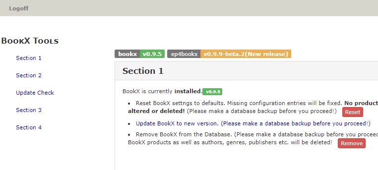

Well.... the world could live happily without this, but for some reason, I've went this way ( complicating again) , but this is want I want to achieve, and I'm achieving, but to compare releases, I need to know what version is install.
Note: Of course I cant write the version, using ftp, notepad++
For the thousands and thousands of bookx users, the universe needs this :laugh::laugh:
Attachment 18253
