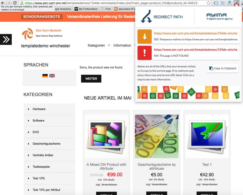

I can not get out of this situation, I tried but nothing seems to zencart does everything to give a 302 and then 404 as an error if the product does not even exist in the online demo is always a rederict 302 to 404. This is not normal and is probably the cause of my problems that I can not get rid of products exist where I can not make a rederict 301. But where there is a url rewriting of the 404 works well does not make the first 302 is directly as a 404 error.
I hope someone will give me the solution. Thanks Gio
Here's an example of a demo of zencart where product ID does not exist from a 302 and then a 404 something completely useless to give a 302 before.
https://www.zen-cart-pro.net/templat...ducts_id=34522
Attachment 16321

Hello MC thank you for answering, I can understand everything but admit chese if a product does not exist instead of getting a 404 I get before a rederict 302. This has affected me for years since I removed the rewrite url. Now I've lost so many location on google ranking that I wonder why no one talks about it and nobody knows what to do to remove this rederict 302 before getting a 404.

Hello MC, has nothing to do with the 1.5.5a version, if you see all of the online demo version have the probleme, that if a product id does not exist does not provide a 404 but first a 302 and then a 404 as an error. as far as my version is a new 1,5,4 never did a rewrite url. I ask you to check the link above to me and you'll see that makes a 302 before and after going to page 404

Hello Kobra, No rederict 302 apart on paypalwpp.php file. But this does not justify why it does, if you see any zencart demo we have the same result ie if the product does not exist does a 302 and then a 404 even if we do not find other header ("HTTP / 1.1 302 Object Moved"); apart on paypal
